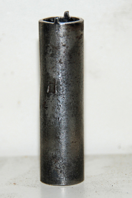

I think I may have covered this before and posted a photo of the tool which I made out of a piece of tube. It was a piece of conduit pipe which I salvaged out of an old house in which the old electrical wiring was run.
I filed the end of the tube to form the two little projections you can see and then slid it down over the switch connectors. I use it to both unscrew and screw up the collar.
The other thing which I do is to work the wire which exits the gearstick somewhere below the gaiter with an action a bit like milking a cow. Work the wire up so that you can disengage the connectors from the back of the switch and then when you are replacing the switch use the same action to pull the wire down the gearstick and allow the plastic top to be pulled down until it almost clips into place. By doing so you are not bunching up the wire beneath the switch itself.
20170407-6184Ptw Gearlever collar spanner.jpg (97.27 KiB) Viewed 2246 times
