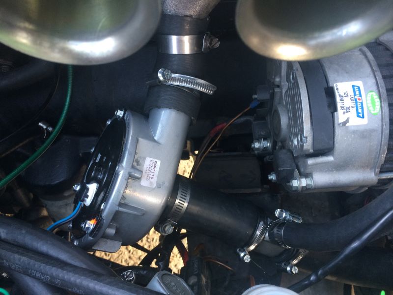

As Steve said, Davies Craig pump doesn't need any further support than the hoses. Pic below is from my race car (which got driven very hard) and this is the bigger EWP115 model. If you want to see how hard it was driven, search YouTube for 'Dolomite Sprint No 20'.

No it goes the other way, from stat housing, through manifold then to heater and back to water pump housing. If you fit an electric pump, the heater return needs to be tee'd into the bottom hose between the pump and the rad or the heater won't work. You can see this return pipe in the pic of Geoff's race car.new to this wrote: ↑Tue Aug 04, 2020 4:28 pmIansprint95m wrote: ↑Tue Aug 04, 2020 11:35 amFrom the bottom of the radiator to the water pump.new to this wrote: ↑Mon Aug 03, 2020 11:00 pm Hi can any one tell me the water flow direction for the Sprint
